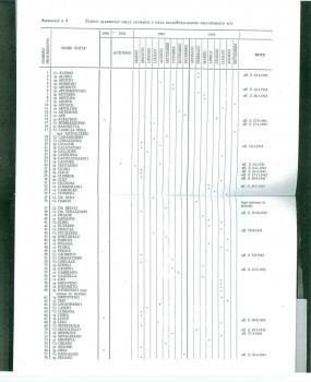

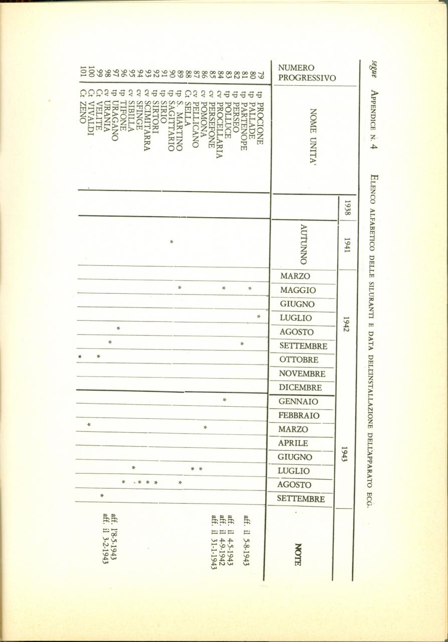

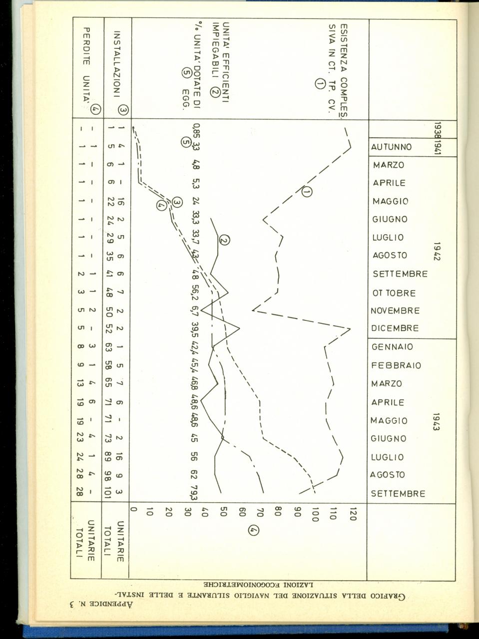

Francesco De Domenico Posted March 13, 2017 Report Share Posted March 13, 2017 Ecco le pagine dal volume USMM "La lotta antisommergibile" dell'amm. div. Vitaliano Rauber, Roma 1978 Giuseppe Garufi 1 Quote Link to comment Share on other sites More sharing options...
