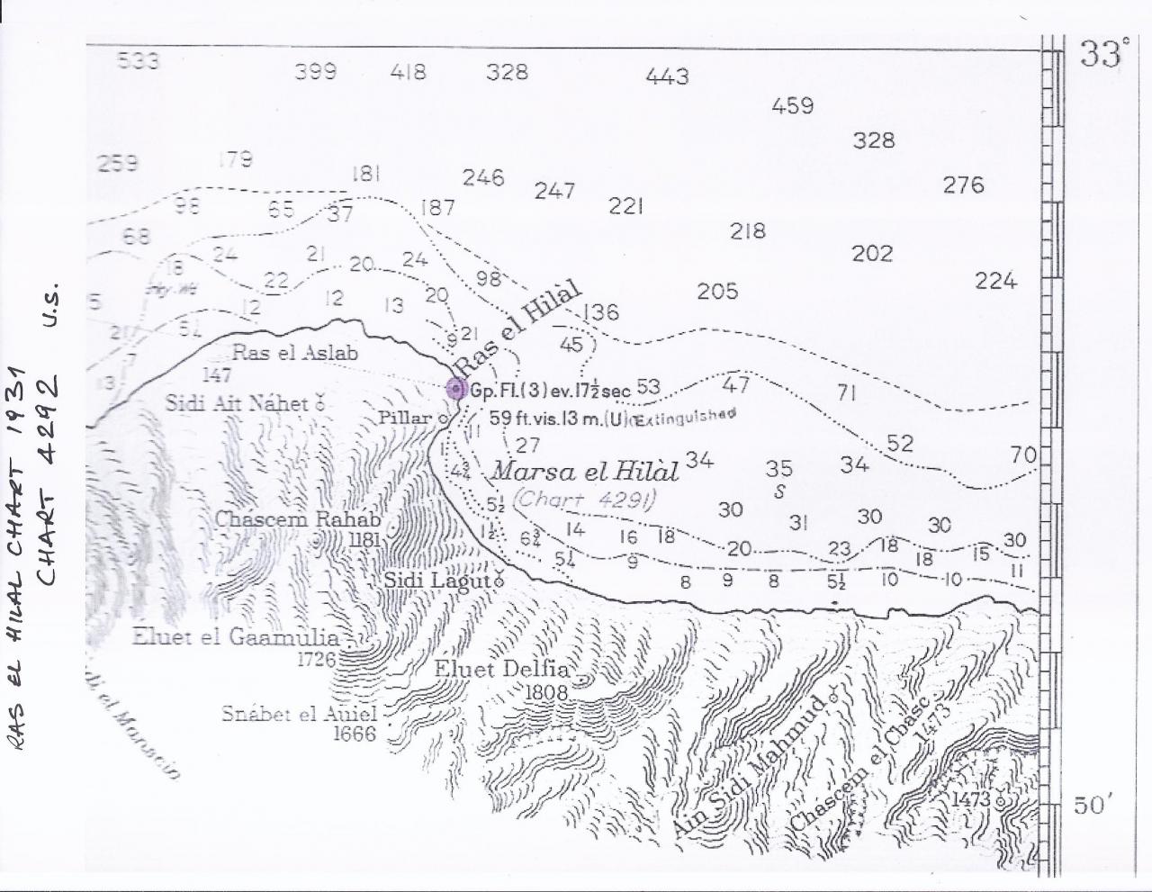

If you read my previous postings, I am not doubting an accident but an accident at Ras Hilal. This is not that the captain of Argonauta would never have carried out a trial dive in Ras Hilal, but that he would have done so by entering the bay unannounced and submerged. If he feared that his submarine might have an accident while diving, it would have been a good idea to try a dive at Ras Hilal but he would have made sure that this was known so that help could be handy if anything went wrong. Otherwise why not try to dive in the middle of the Mediterranean? Perhaps you can give me reasons for entering the bay stealthily unless her captain committed gross negligence. No comments on my documents or are you still clinging on the idea that HMS Decoy sank Argonauta at Ras Hilal? I rest my case.
-There was nothing and nobody at Ras el Hilal in 1940 , to which or to whom Argonauta could/should have announced  anything.
-Marsa el Hilal is an ideal place for a submarine to rest on a sandy bottom , protected from prevailing wind and  current.
 Under the thread U-205 , URGE , ARGONAUTA , on this Forum , you should find my Post about at least one other British  submarine having rested exactly there for half a day...
 "Otherwise why not try to dive in the middle of the Mediterranean" ???
 I hope you will concede that resting on the seabed in 20 - 25 fathoms without any need to keep an eye on depth and  trim is  more attractive than diving in the middle of the Med  !!!   :  just look at the depth contour lines for Ras el Hilal  !

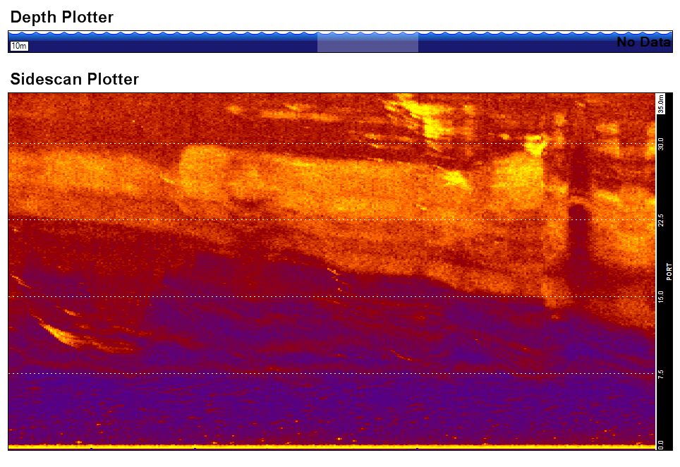

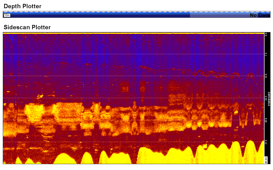

An additional evidence that one of the submarine wrecks at Marsa el Hilal is HMS URGE
as I have claimed in April 2015 :

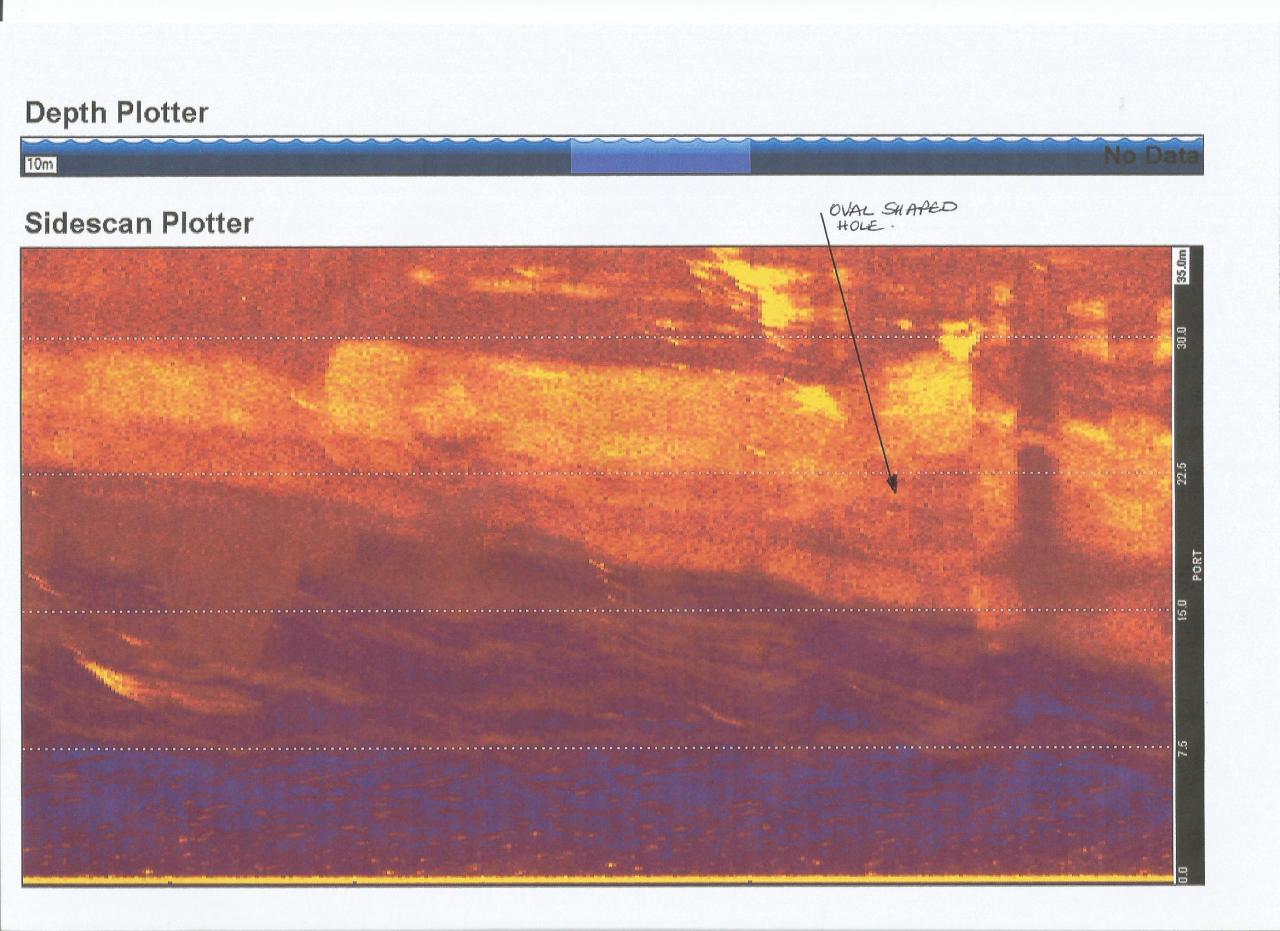

The oval hole  (function not yet fully determined)  appearing on the vintage picture can
be seen on the sonar image.
The last attachment is the Depth Profile , showing the protruding Conning Tower.
Contrary to Wikipedia's position (HMS URGE having hit a mine off Malta...)
....HMS URGE is lying right in the middle of the roadstead MARSA el HILAL , Libya.
It is about time so-called "historians" stop referring to inexisting archives , stop giving "opinions" on
the "most likely cause" of the loss of  HMS URGE and start considering Sonar Images as valid evidence !

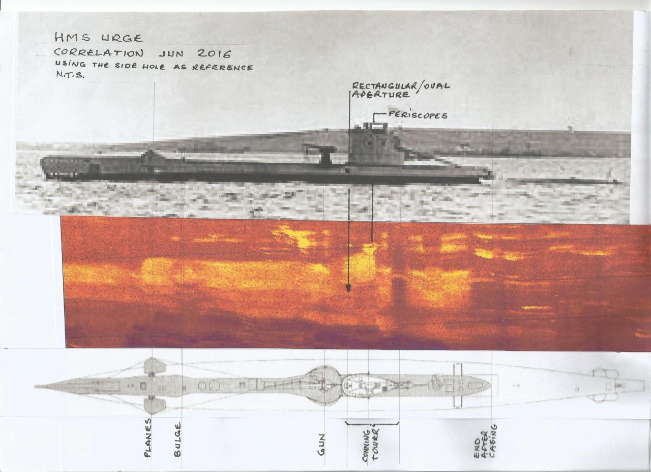

A complement :

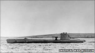

The Correlation between a vintage picture of HMS URGE , a Drawing and the Sonar Image.
The rectangular aperture on the side of the hull (preceding Post) has been taken as a reference.
"Imagination"  ???
Certainly not !
The sonar tells the truth : HMS URGE is resting on the seafloor at Marsa el Hilal.

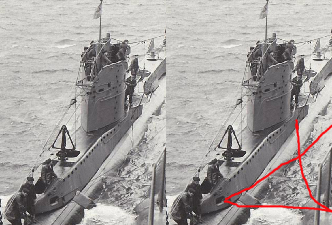

On all British submarines , U Class :
An Isolated , Rectangular Aperture on the side of the Casing , between the Gun Platform
and the Conning Tower (the exact need for this aperture is being investigated)
This aperture can be readily seen on the sonar image , 2012 , of a submarine resting on the

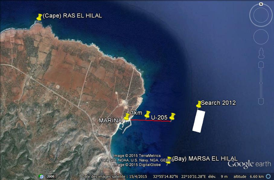

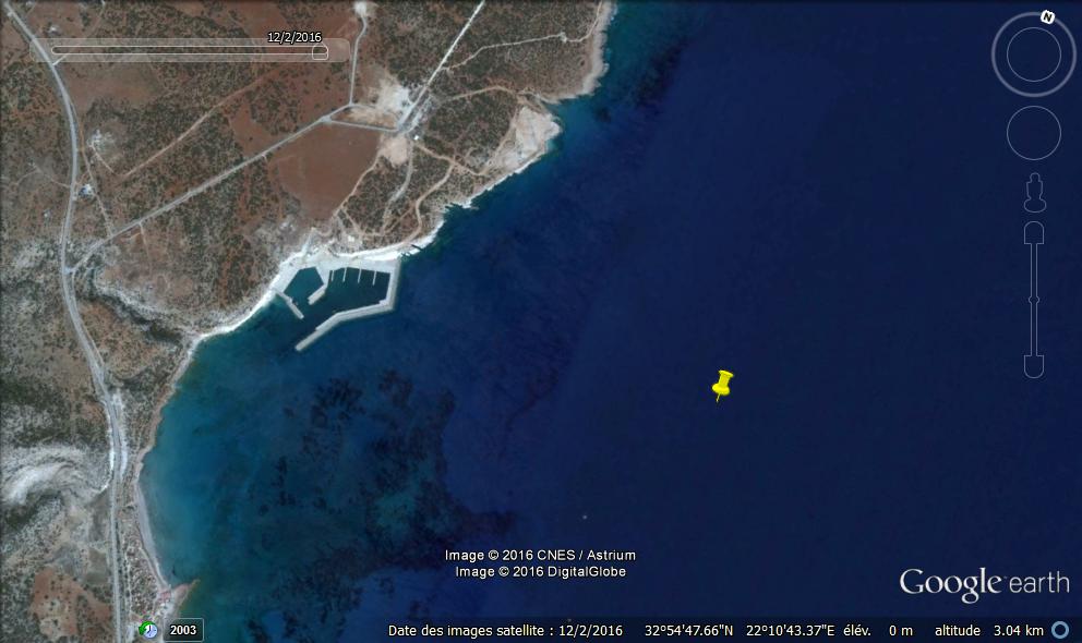

seafloor at Marsa el Hilal   (P.A.  32° 54'  N       22°  11'  E)
Google Earth picture  : "Area sonar-searched , 2012"
The sonar snapshot is therefore of the wreck of HMS URGE , lost on June 29 , 1942

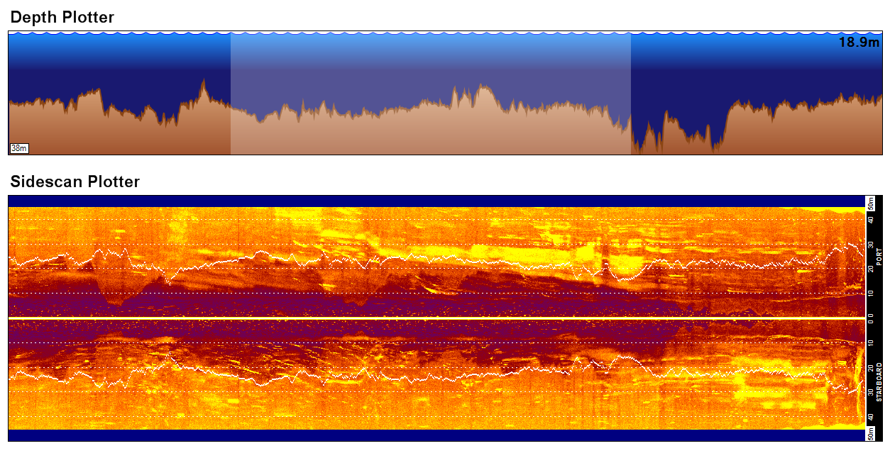

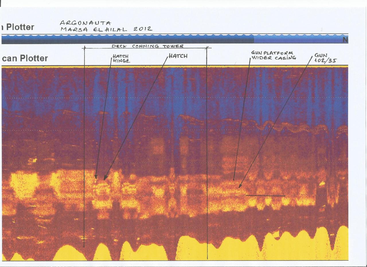

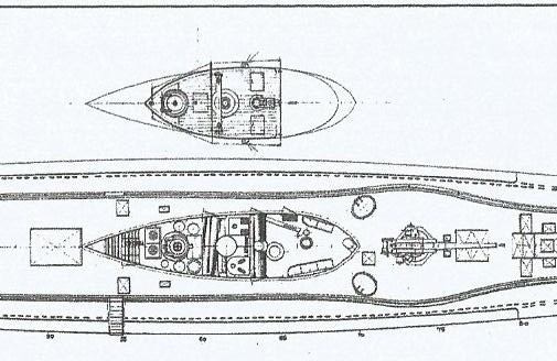

An update on the sonar image analysis of this wreck :
The position of the Hatch of the Conning Tower is indicated on the annotated sonar image , attached.
Although the Plan drawing shows that only the bottom hatch has a cross-shaped wheel , the sonar image
shows a similar cross-shaped wheel on the deck hatch.
No submarine design , other than the Italian "Classe 600" puts a C.T. Hatch in this position.
Therefore , being an Italian "Classe 600" submarine , this wreck is of ARGONAUTA , lost June 28 or 29 , 1940.
The wreck lies in Marsa el Hilal , Libya , in P.A.   32°  54'  N      22°  11'  E
...in the area sonar-searched in 2012 , as indicated on the attached Google Earth picture.
Just as for HMS URGE , resting in the same perimeter , this submarine is the tomb of its entire crew.
Edited by JPMISSON

It is agreed that to identify a wreck from its sonar image , three things are needed  :
-a vintage Picture of the vessel
-a constructional Drawing
-some hint as to the presence of the vessel in the area , at the time of disappearance
For HMS URGE , ARGONAUTA , HMS QUENTIN , S 35 , PICCI FASSO  this is precisely what we had prior to
working at deciphering the sonar recording .

HMS URGE (Sonar recording Libya , 2012)
Aside from the general correlation submitted in April 2015 , the presence and the position of a distinct
aperture on the Port side of the casing (between Gun Platform and Conning Tower) denotes a U Class unit.
This wreck , therefore , is re-confirmed British sub  HMS URGE . See AIDMEN Relitti Marsa el Hilal .
ARGONAUTA (Sonar recording Libya , 2012)
The sonar image reveals the Hatch of the Conning Tower (still shut) positioned at the rear of the C.T. deck.
This corresponds to the Plan drawing we have of the  "Classe 600 - Serie Argonauta".
This wreck , therefore is re-confirmed Italian sub ARGONAUTA 2° . See AIDMEN Relitti Marsa el Hilal .

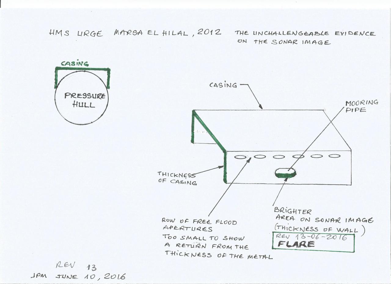

HMS URGE
THE SONAR IMAGE OF THE WRECK AT MARSA EL HILAL , LIBYA .
THE APERTURE SEEN ON THE SIDE OF THE CASING.
On a sonar image the "return" from a metal structure is coloured (there is a choice of colours)
When there is no metal there is no "return" : the corresponding area is uncoloured or dark .
On the sonar image of HMS URGE the rather large and oblong Aperture on the side of the Casing
(between the Gun Platform and the front edege of the Fin) appears as a dark area (hole) ...
except for the bottom part of this dark area which looks bright.
This is due to the "return" of the sonar wave having hit a narrow area of metal : the THICKNESS
of the Casing.
The Casing is an additional Deck affixed to the cylindrical-shaped Pressure Hull which is the main
body of a submarine . Walking , working , manning the Gun on the Pressure Hull would not be
possible without a flat Deck : the Casing.
The Casing is made of a thinner steel than the Pressure Hull.
Though small , the thickness of the Casing shows up on the sonar image , where the Aperture is located.

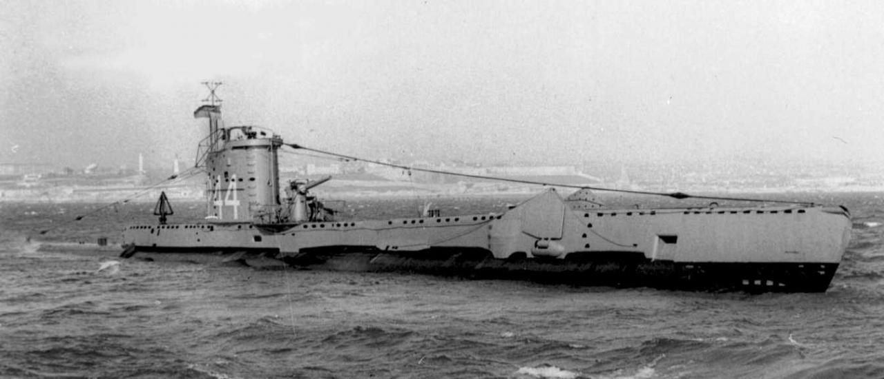

The attached vintage picture is of HMS UNITED , of the same "U" Class as HMS URGE : the Aperture in
the side of the Casing is seen between the Gun and the Fin.
This Aperture exists on both sides of the submarines U Class (see earlier Post #51)
The Aperture is identifiable on the sonar image of the submarine at Marsa el Hilal  :
This is the unchallengeable  evidence the wreck is that of HMS URGE.

Re : the sketch on Post #54
The closeup picture showing the rather large metal area (the flare) all around the inside of the two large
side openings on the side of the Casings  (British U Class submarines)  has been most useful to explain the
"return" from that place when hit by the sonar wave.
There would have been no bright trace on the image had it not been for that flare (the thickness of the

The sonar image is not of U-205 because this German submarine is some 700 m away from the area sonar-searched in 2012 as shown on the attached Google Earth picture . There is no way the Tritech sonar model Starfish 450 would have detected something that far !
Besides , the sonar image shows the short after Casing of a British U Class : (it does not show the entire hull) ...a type VIIC would have shown a considerably longer body.
As for the article in the Italian publication STORIA MILITARE we shall arrange for a translation in English and Readers will value its content by themselves.
However "I find it amusing" to see how the Italian point of view is so contemptuously dismissed ...
Whether you like it or not , the loss of HMS URGE was subsequent to an attack by their planes in their waters and under the eyes of some of their German allies.
Any good reason why anyone would expect to find anything on this event at Kew ?

Addendum to Post #54 :
The revised sketch outlining the FLARE around the "Mooring Pipe"

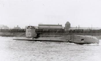

As shown on all vintage pictures of British U Class submarines , there were two such "Mooring Pipe" on the side of the Casing , Port and Starboard .
It is the appreciable width of the Flaring which caused the "return" of the sonar wave to show up on the sonar image.
The sonar image shows that the Mooring Pipe on the wreck is exactly where vintage pictures show it is , on U Class boats (Posts # 51 , #54).
This is the unquestionable evidence the wreck is of a Class U British submarine ...therefore of HMS URGE as documented in the article of  STORIA MILITARE , April 2016 issue.
Edited by JPMISSON

The true fate of HMS URGE  has been revealed by a sonar recording , Marsa el Hilal , in 2012 .
History is not only found in Archives .
More examples are to come .
It is about time sonar imagery is considered a valid tool , providing valid evidence .
The aperture (the Mooring Pipe) seen on the side of the casing of the wreck of HMS URGE  is
just an example of how revealing a sonar image can be .
