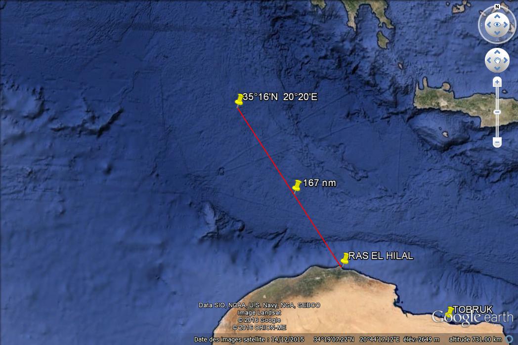

On 29 June 1940 around 0615hours the Italian submarine Argonauta (offsite link) was probably sunk near Cape Ras el Hilal, Libya in position 35°16'N, 20°20'E by the British destroyers HMS Dainty (Cdr. M.S. Thomas, RN), HMS Decoy (Cdr. E.G. McGregor, RN), HMS Dhttp://uboat.net/allies/warships/ship/5629.html
The attached Google Earth picture shows the position indicated in UBOAT.NET :    35°  16'  N       20°  20'  E
How can one believe this statement  ???  This is 167 nm away from Ras el Hilal .....
PROBABLY  ..?
"NEAR" CAPE RAS EL HILAL ...?
There is reason to doubt the validity or accuracy of this information.
If indeed the British vessels encountered the ARGONAUTA 2° and took action against her it must have been much closern(really near Cape Ras el Hilal as quoted in the report) and not 167 nm away....

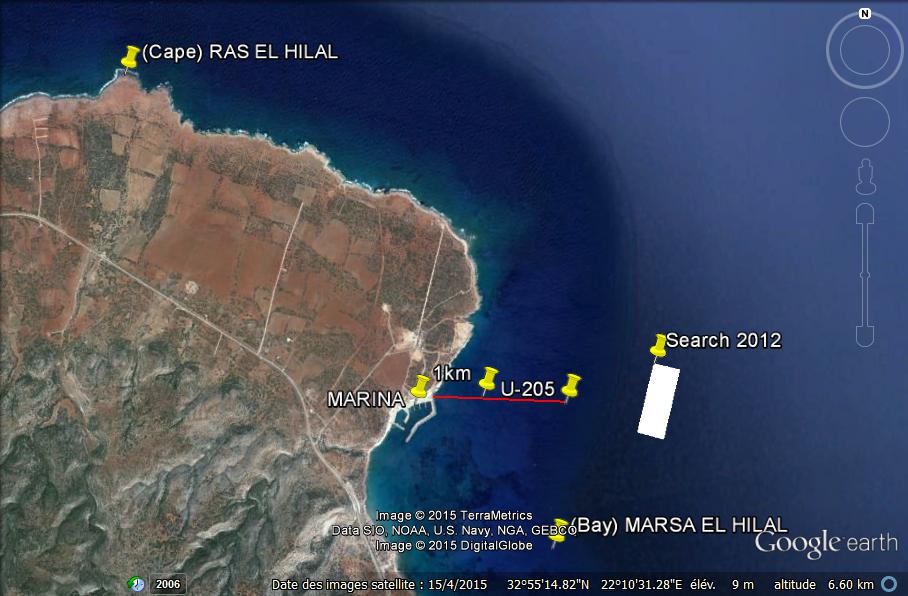

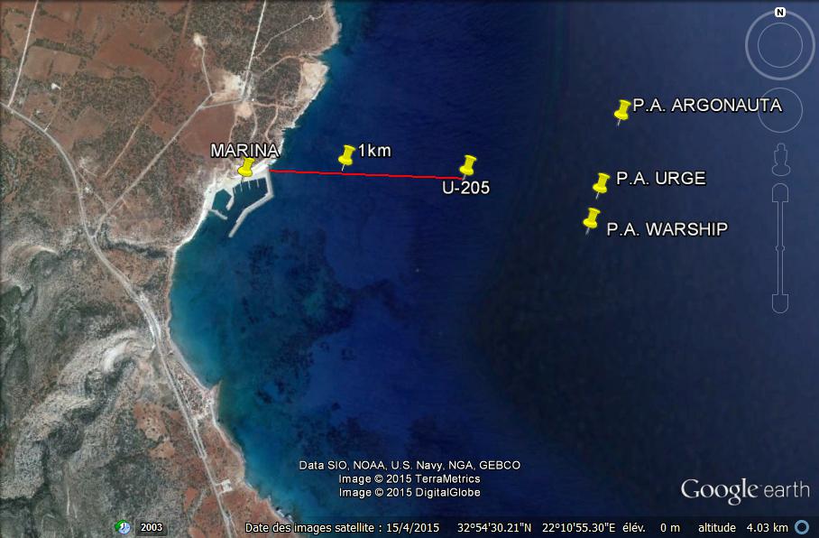

The sonar recording Marsa el Hilal 2012 shows a submarine , Italian Classe 600 , as per correlation with vintage pictures and original drawings .
ARGONAUTA 2° is in P.A.    32°  54'  N     22°  11'  E

On 29 June 1940 around 0615hours the Italian submarine Argonauta (offsite link) was probably sunk near Cape Ras el Hilal, Libya in position 35°16'N, 20°20'E by the British destroyers HMS Dainty (Cdr. M.S. Thomas, RN), HMS Decoy (Cdr. E.G. McGregor, RN), HMS Defender (Lt.Cdr. St.J.R.J. Tyrwhitt, RN), HMS Ilex (Lt.Cdr. P.L. Saumarez, DSC, RN) and the Australian destroyer HMAS Voyager (Lt.Cdr. J.C. Morrow, RAN).
"PROBABLY"  ...?
......There is reason to doubt the accuracy of this information.

I agree that the description used on uboat.net as "near Ras Hilal" is misleading. The description could have used "west of Crete" more accurately.  I do not know who wrote it but if one should complain about it then one should write to uboat.net. This is not in the original British report. This error does not justify the claim that ARGONAUTA was lost at Ras Hilal.
UBoat.net  Posts # 16 and 17

This I retain correct , for the DATE and for the LOCATION , as Argonauta 2° is indeed on the seafloor at Marsa el Hilal , as per the sonar picture 2012 .
The figures (the coordinates) do not make sense . A well-known NAMEPLACE (Marsa el Hilal) makes a lot more sense .

You are quite right. Submarines have been known to travel after being sunk (about 170 miles in the case of ARGONAUTA). This was common knowledge but I had forgotten. Thank you for reminding me. :)  Please send your list of submarines at Tabarka as soon as possible. However, it seems we really had bad luck as all these submarines after being sunk travelled to Tabarka all these distances only to founder just about a mile or so from the shore. None of them ever got beached. Bad luck!

In case you are still clinging to the theory that HMS Decoy sank Argonauta in the Bay of Ras Hilal:
I have informed uboat.net that the term "near Ras Hilal" was loosely used in their text as the position 35°16' N, 20°20' E is the correct one (with slight variation from one destroyer's report to another). I have sent them the copy of the documents involved to prove it but knowing your contempt for archive work, they are no use for you as you know better.
Uboatnet has corrected it.
I repeat for those interested: HMS Decoy and four other destroyers did sink Uebi Scebeli and attack Tarantini and Salpa. With the many depth charge attacks of the morning of 29 June, they may have sunk a second submarine which could be Argonauta but we cannot be positively sure and this would be west of Crete not at Ras Hilal.
