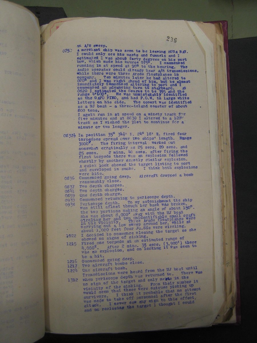

Platon Alexiades Posted July 24, 2021 Report Share Posted July 24, 2021 Hello, On the subject of attacks on ships carrying PoWs, I have no specific comment on the Mario Roselli case as perhaps the pilot was unaware that the ship had a human cargo. However, I would point out a more serious case is that of Petrella (ex-Capo Pino) sunk by the submarine HMS Sportsman (Lt. R. Gatehouse, DSC, RN) on 8 February 1944. Gatehouse clearly saw the letters "POW" painted on the hull before he ordered the torpedoes fired. I quote from his patrol report: "He was unmistakably identified as the CAPO PINO and had P.O.W. in large white letters painted on his side." A few minutes later, HMS Sportsman fired four torpedoes. We know from German documents that there were 2,647 victims. It is also interesting to note that after Gatehouse submitted his patrol report, his flotilla commander (Captain D.C. Ingram, DSC, RN of the First Submarine Flotilla based at Beirut) did not ignore that his target had carried PoWs, however he made no negative observation but congratulated Gatehouse with the comment: "SPORTSMAN is to be most heartily congratulated on a finely executed attack and an extremely useful contribution to the Aegean war effort, observing that lack of shipping is causing the gravest embarrassment to the enemy." Obviously, Ingram and Gatehouse were more interested in eliminating enemy ships at all cost, even if those carried PoWs. I am not an expert in International Law and I will let others decide if this was a war crime. There were other instances of British submarines sinking ships carrying PoWs but these were British nationals and the sinking were usually made because the submarine commander was unaware of the fact. I will also make the remark that this casual attitude was not necessarily the norm in the Royal Navy. When HMS Utmost (Lt. J.W.D. Coombes, RN) shelled a small village on Linosa island on 25 September 1942, his flotilla commander (Captain G. Simpson of the 10th Flotilla in Malta) did not approve of the action and criticized Coombes with the comment: " ...I am not in favour in bombarding small villages, this seems to be carrying total war too far, and be of no material benefit to the war effort." I found the latest comment quite remarkable considering that Malta was at the time heavily bombed by the Axis air forces and civilians were being killed daily. Best regards, Platon sandokan, Napy and antares 2 1 Quote Link to comment Share on other sites More sharing options...

Michele barile Posted October 29, 2021 Report Share Posted October 29, 2021 On 7/24/2021 at 5:03 PM, Platon Alexiades said: Hello, On the subject of attacks on ships carrying PoWs, I have no specific comment on the Mario Roselli case as perhaps the pilot was unaware that the ship had a human cargo. However, I would point out a more serious case is that of Petrella (ex-Capo Pino) sunk by the submarine HMS Sportsman (Lt. R. Gatehouse, DSC, RN) on 8 February 1944. Gatehouse clearly saw the letters "POW" painted on the hull before he ordered the torpedoes fired. I quote from his patrol report: "He was unmistakably identified as the CAPO PINO and had P.O.W. in large white letters painted on his side." A few minutes later, HMS Sportsman fired four torpedoes. We know from German documents that there were 2,647 victims. It is also interesting to note that after Gatehouse submitted his patrol report, his flotilla commander (Captain D.C. Ingram, DSC, RN of the First Submarine Flotilla based at Beirut) did not ignore that his target had carried PoWs, however he made no negative observation but congratulated Gatehouse with the comment: "SPORTSMAN is to be most heartily congratulated on a finely executed attack and an extremely useful contribution to the Aegean war effort, observing that lack of shipping is causing the gravest embarrassment to the enemy." Obviously, Ingram and Gatehouse were more interested in eliminating enemy ships at all cost, even if those carried PoWs. I am not an expert in International Law and I will let others decide if this was a war crime. There were other instances of British submarines sinking ships carrying PoWs but these were British nationals and the sinking were usually made because the submarine commander was unaware of the fact. I will also make the remark that this casual attitude was not necessarily the norm in the Royal Navy. When HMS Utmost (Lt. J.W.D. Coombes, RN) shelled a small village on Linosa island on 25 September 1942, his flotilla commander (Captain G. Simpson of the 10th Flotilla in Malta) did not approve of the action and criticized Coombes with the comment: " ...I am not in favour in bombarding small villages, this seems to be carrying total war too far, and be of no material benefit to the war effort." I found the latest comment quite remarkable considering that Malta was at the time heavily bombed by the Axis air forces and civilians were being killed daily. Best regards, Platon Platon, Thank you so much for the details that enrich your comments. I'm interested in Petrella, unfortunately for family reasons. Whether Gatehouse clearly saw the letters on the ship, is somehow debated. It appears that Jürgen Rohwer writes so in his "Allied submarine attacks of ww II"; since you mention Gatehouse's report , could you kindly provide the sources of your statements? Was it one of the ADM? On the same token, Sportsman was around 4,000 yards far away from the ship: would the attack periscope , Barr & Stroud , CH 40 able to show the letters POW? Is anybody, in the forum, able to give me an answer? Nevertheless, you made veeeery interesting points. Appreciated! antares 1 Quote Link to comment Share on other sites More sharing options...

Platon Alexiades Posted October 29, 2021 Report Share Posted October 29, 2021 5 hours ago, Michele barile said: Platon, Thank you so much for the details that enrich your comments. I'm interested in Petrella, unfortunately for family reasons. Whether Gatehouse clearly saw the letters on the ship, is somehow debated. It appears that Jürgen Rohwer writes so in his "Allied submarine attacks of ww II"; since you mention Gatehouse's report , could you kindly provide the sources of your statements? Was it one of the ADM? On the same token, Sportsman was around 4,000 yards far away from the ship: would the attack periscope , Barr & Stroud , CH 40 able to show the letters POW? Is anybody, in the forum, able to give me an answer? Nevertheless, you made veeeery interesting points. Appreciated! Hello Michele, My apologies for the late answer. I had missed your post and we must thank Francesco for reviving the topic. I am attaching the relevant page from the HMS Sportsman patrol report. Source is ADM199/508 (TNA). I hope it answers your question. Best regards, Platon antares and Francesco De Domenico 1 1 Quote Link to comment Share on other sites More sharing options...
