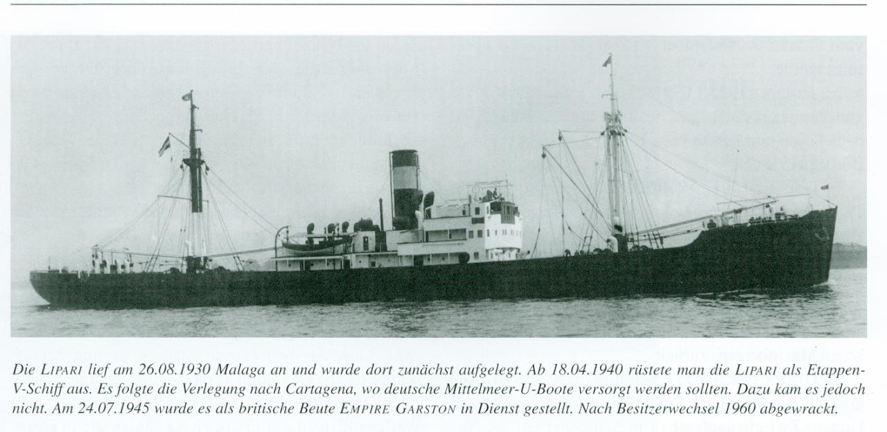

Francesco De Domenico Posted March 20, 2017 Report Share Posted March 20, 2017 LIPARI, 1,943 grt/1930, owner Sloman of Hamburg, had sailed from Genoa on 2 August 1939 on her home return trip. She put into Cartagena on 25 August and into Malaga on 26 August, where her skipper required a written order from the local German consul not to sail again, while at the same time trying to get coal enough for her home journey, but the existing stocks only came up to 140 tons, while foodstuffs and drinking water were also in short supply. From the German embassy in Madrid came the request to transfer her coal cargo to the OTTO LEONHARDT, 3,682 grt/1911, Leonhardt & Blumberg, also in Malaga at the same time (arrived from Rotterdam via Oran). After the British entry into the war on 3 September, it was too late to attempt anything, and the rigid attitude of the German representative in Spain had prevented any attempt at homecoming on her part. She was laid up in the outer harbour on 28 October. She was then earmarked on 18.4.1940 to be employed as a stationary Mediterranean U-Boat refuelling ship in Cartagena (Etappen U-Boot-Versorger), but was never employed as such; delivered by Spain to Great Britain as a war prize on 24 July 1945, taking the MoWT name EMPIRE GARSTON. Sources: - Cai Boie, Bernd Oesterle, "Die deutsche Handelschiffahrt bei Kriegsausbruch 1939", Elbe-Spree Verlag, 2000 - Ludwig Dinklage, Hans Juergen Witthoeft "Die deutsche Handelsflotte 1939-1945. Die Schicksale aller Seeschiffe ueber 100 BRT", Nikol Verlag, 2001. Quote Link to comment Share on other sites More sharing options...

Francesco De Domenico Posted March 23, 2017 Report Share Posted March 23, 2017 Foto del piroscafo LIPARI, da Cai Boie-Bernd Oesterle, "Die deutsche Handelsschiffahrt bei Kriegsaubruch 1939", Elbe- Spree Verlag, 2000. Quote Link to comment Share on other sites More sharing options...
